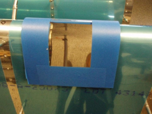

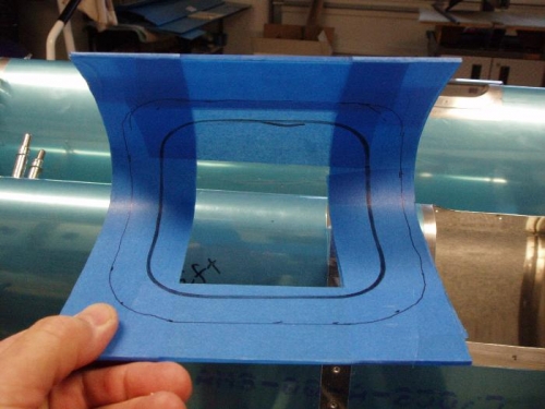

Next I cut the lens to fit. I put tape around the edge to prevent cracking during cutting. I measured it up through the hole and drew a line. Then I measured a 3/4 offset and drew another line which is the cut line. I cut it on the bandsaw and that worked really well. Cleaned up edges with sandpaper and scotchbrite.
Masking Tape on Lens to protect it
Captured cut line
Captured cut line
Cut it on the band saw
