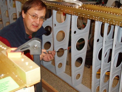

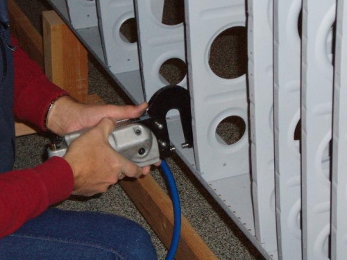

Brief Description:  Main Skins - Debur, Dimple Top Skins, Frame 4

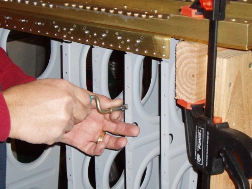

I finished the right wing today. This entry is for the purpose of capturing the 4 hours that it took to Debur, Dimple, and countersink a little. It takes a long time to debur the top skins, the spars and ribs for the main skins. After dimpling I turn the debur tool 5 turns to open up the dimple a little to receive the skin dimple.
Deburring right wing frame

Dimpling right wing frame
Dressing up dimples a little 5-turns
