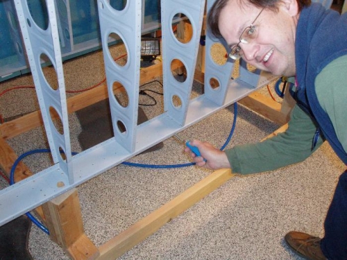

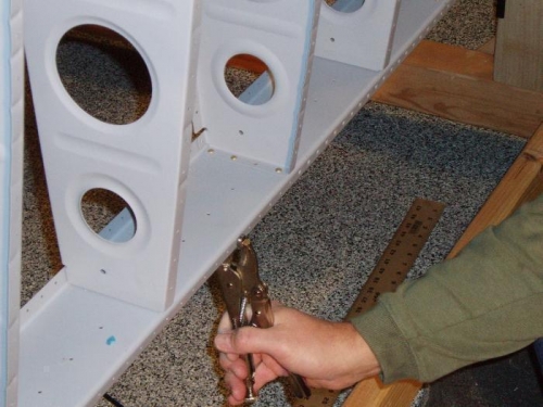

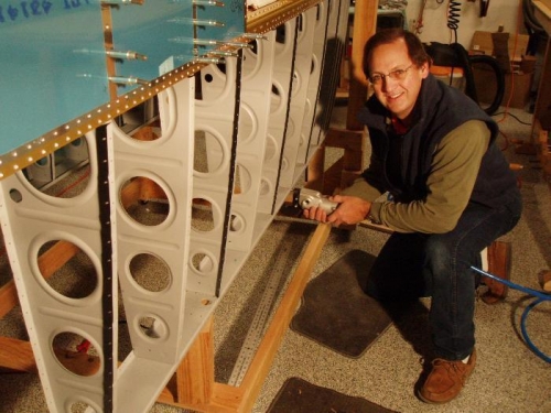

Then I deburred all the holes in the frames, and spars. shshssh, this took forever. Then I started dimpling all the holes, but I got tired of squeezing my hand dimpler so I switched to using the pneumatic squeezer. Finally I touched up all the dimples with a debur tool. 5 turns. I tried using the countersink bit in the cage but it didn't work as well, seemed like a bit of overkill,
