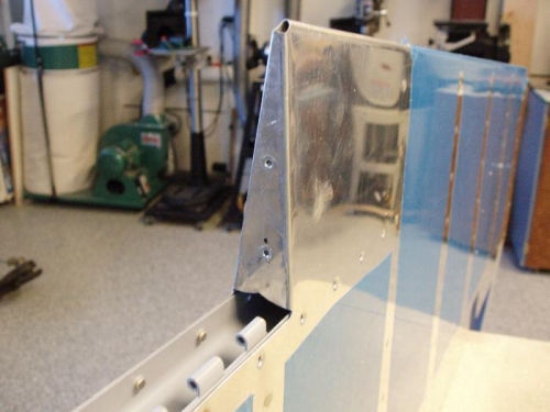

Brief Description:  Elevator - Left Trim Tab Rivets
I used flush pulled rivets and it worked pretty good.

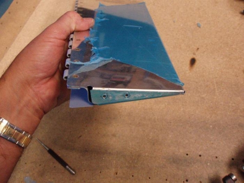

ERROR - for those reading photo 2 below shows an error. It looks like I trimmed of the hole that is suppose to be used for the electric trim. And I've connected my electric trim to the hole for manual cable trim. Now that I'm ready to fly this results in a loss of movement of 10 degrees up and down. To fix it I'll have to put on a new horn.
Flush Rivets in elevator tab

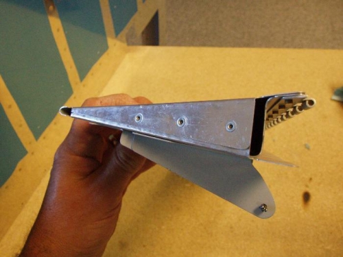

Flush rivets in trim tab inboard
Flush rivets in outboard trim tab
