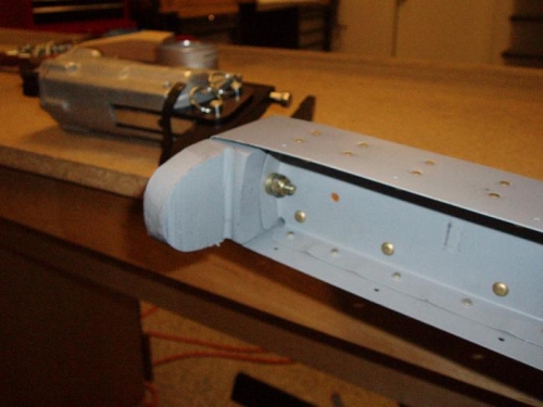

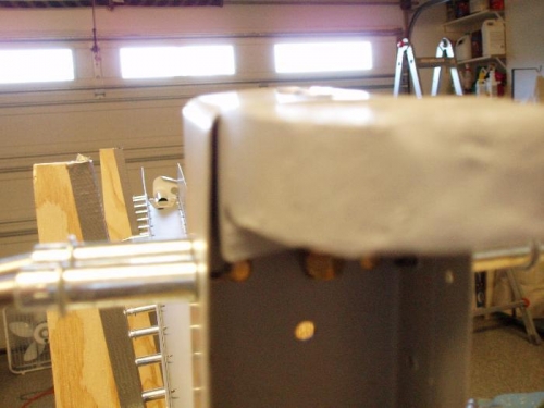

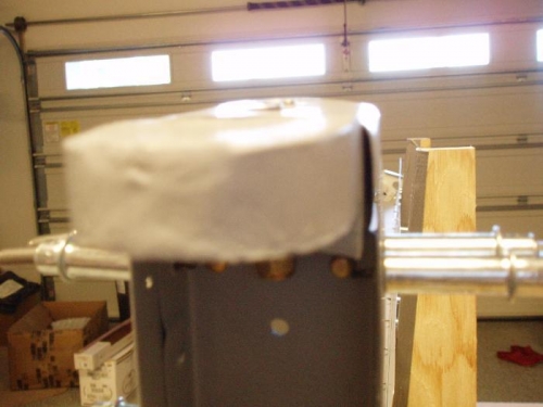

I deviated from the drawing today. Instead of trimming the fiberglass tip to fit around the counter balance, I sanded off a little counter balance weight to make room for the tip to slide between the weight and skin.
Seel slight gap so tip will slide in

Gap on other side

I had to use two washers.
