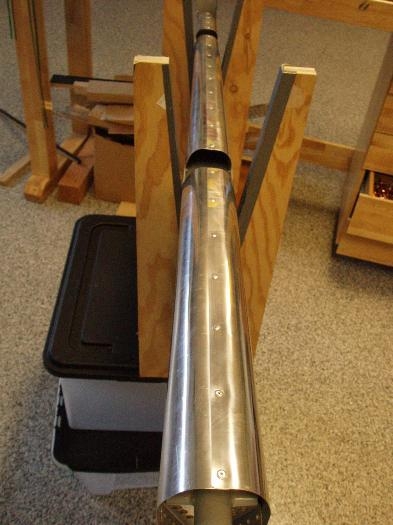

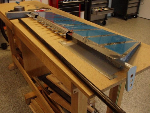

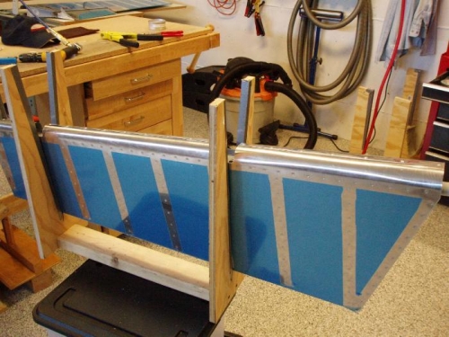

Brief Description:  Elevator - Rt Roll Leading Edge
I finished off the right elevator by rolling the leading edge. I used a 1 inch pipe. Not good, next time I'll use a 1/2 inch pipe to get a little tighter bend without bending it at the rivet line. According to plans top skin is over the bottom skin so no water leaks in.
Bending with 1
Bending with 1" pipe
Top Skin over the bottom skin
Next time use 1/2 pipe
