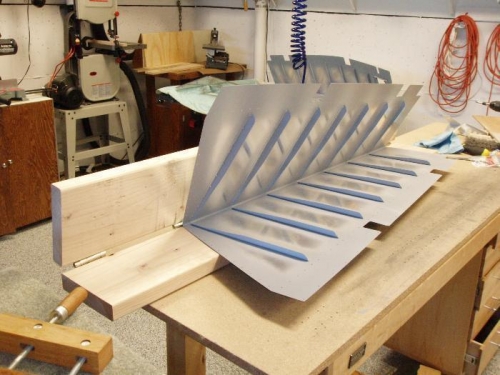

Brief Description:  Elevator - Rt Bending the trailing edge
Here is the first bend with the 1/8th inch gap. Notice I got the bender fully closed, but there was still about 8 inches of spring back, which is too much. So I removed the hinges and reset them with zero gap.
Elevator against hinges for bending

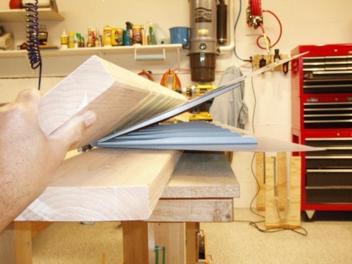

Fairly easy to bend
Fairly easy to bend

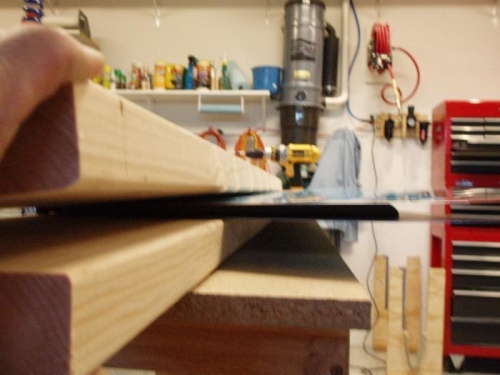

Not a lot of pressure required to fully bend
