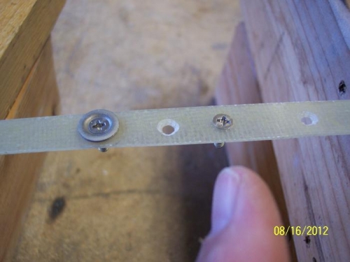

I looked at various ways to hold down the fairing. Drawing calls for 6-32 screws. Many on Vans Airforce use Tinnerman washers. I decided to just use the screws with no washers. I decided this mostly because it requires minimum countersink to the fairking.

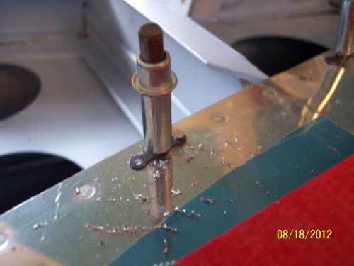

All the holes need K1000-6 nut plates. I was able to rivet them all excep the two aft ones on the HS, because there is no room. I need to get some platenutes with holes on one side.
Using just #6 screws

Drilled from the top
