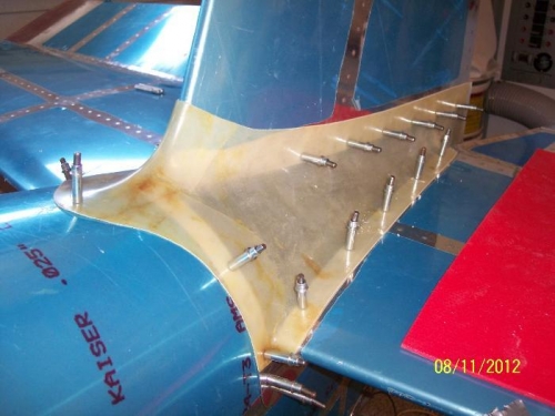

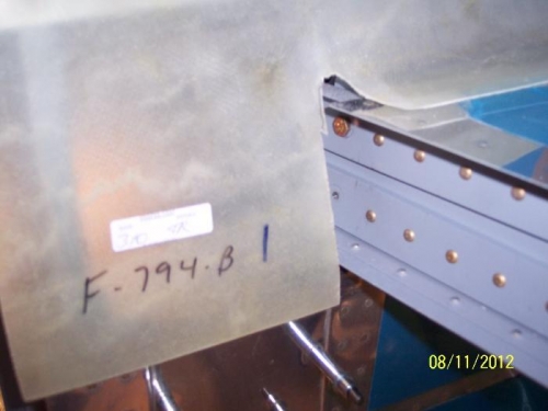

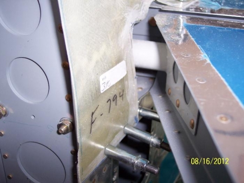

The fairling needed triming at the aft end. Some material was removed to ensure at least 1/4 clearance with the elevator bell crank. The aft end and bottom got trimmed off.
The whole thing cleos on pretty good, but there are still some gaps to fill and I'm not sure how yet.
This aft end gets trimmed
1/4 inch clearance of elevator
Fairly good fit w/ some gaps
