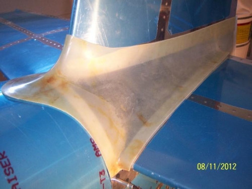

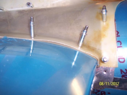

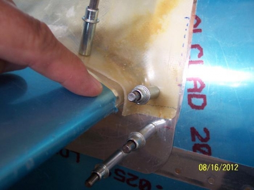

The plastic fairing fits pretty well, but I can see a couple gaps. I'll have to figure out how to fix these gaps. Most of the gap problems are on the co-pilot side.
I match drilled the fairing. Note: drill the holes in the horizontal first, then the holes in the vertical. Otherwise you might get the fairling up too high.
I also enlarged the holes in the fairing by countersinking it with a #40 bit just enough so that the #6 screws would sit flush.
Basic fit is good
Basic fit is good
See the gap
See the gap
See the gap?
See the gap?
