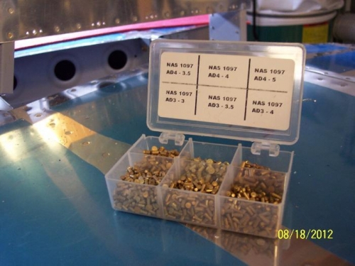

I used NAS rivets because they have minimal heads and require only a slight countersink in the aluminum sheet. I squeezed all the rivets except for the one platenut on the top center. This one had to be pounded.
Used NAS rivets

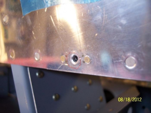

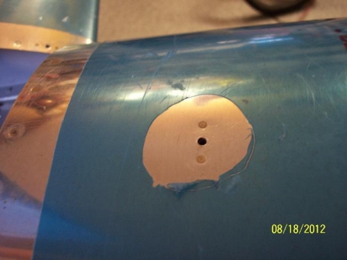

Plate nuts installed
Top forward platenut
