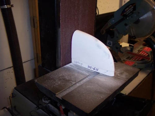

I use the sanding belt to smooth and trim the size of the plastic tip.

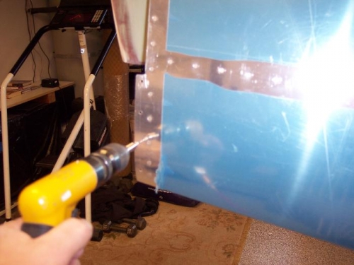

Next I drilled 3/32 pilot holes in the HS. Per drawing they should be 1.5 inches apart. That makes 4 holes per side.
Sand to final size
Drill pilot holes
1.5 inches apart
