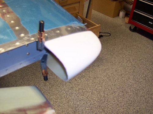

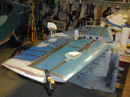

Moving on to another plastic tip. This is the tip on the horizontal stabilizer (HS). First get the parts laid out. Then the tip needs to be trimmed to fit. I attached the elevators to ensure clearance between them and this HS tip.

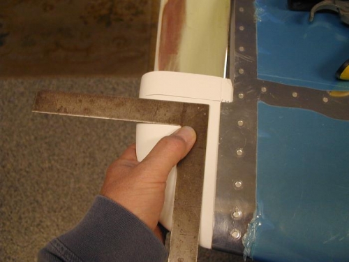

I used a square to cut the back of the tip 90 degrees to the edge of the HS.
HS tip parts
HS tip parts
Attached elevators
Attached elevators
Trimmed off tip 90 degrees to HS
