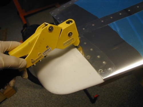

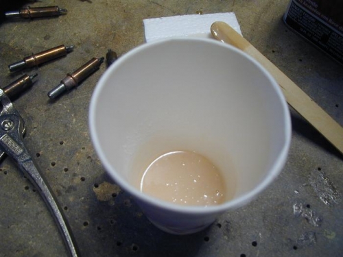

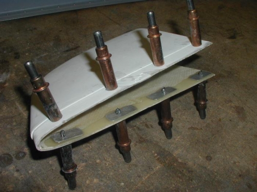

I use expoxy to glue on the aluminum washers. They will be held by the pulled rivets. I rivetted on the tip. I also glued it on using fliberglass resin/hardner.
Glued on washers expoxy
Rivet on tip
Also glued on the tip
