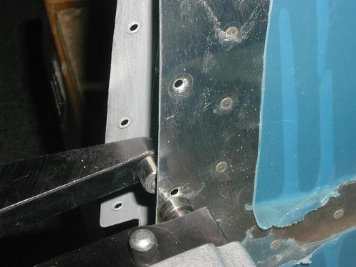

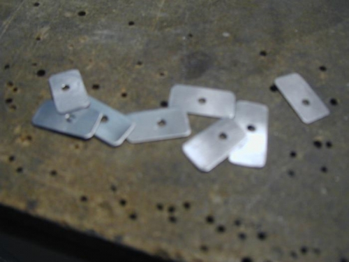

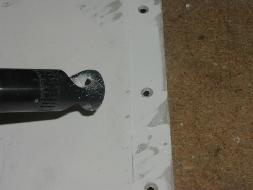

I counter sunk the fiberglass tip holes and dimpled the VS skin. I made some aluminum washers for under the pulled rivets.
Counter sink the tip
Some aluminum washers
Dimpled the VS skin
