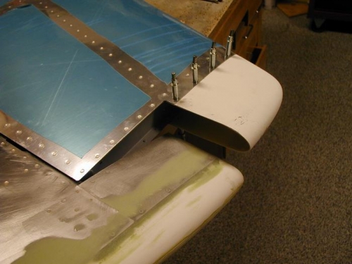

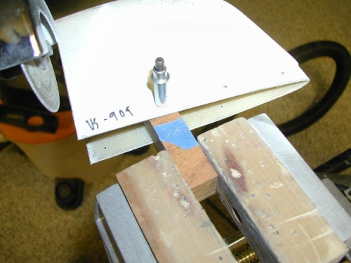

The VS tip is too long. The rudder needs to swing thru behind it. So I didn't want to make it a snug fit. I trimmed off the aft end of the tip leaving about an 1/8 gap. I used the cutting disc to trim it.
Tip too long

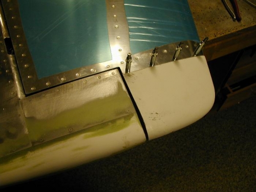

Trimmed off aft end
About 1/8 gap.
