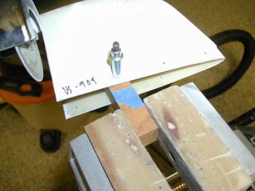

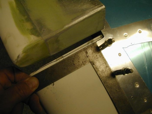

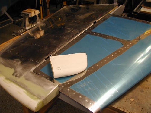

Next tip is the top of the Vertical Stabilizer. I had to assemble the rudder to the vertical fin first so the plastic tip of the rudder would be in position. I stuck the tip in place and drilled it. Then I marked the cut off line. The tip is a little long so you have to cut a little off. I clamped it and used the cut off wheel to remove the extra plastic tip.
Rudder on Fin
Rudder on Fin
Cut off extra after drillng in place
Clamped and used cut off wheel
