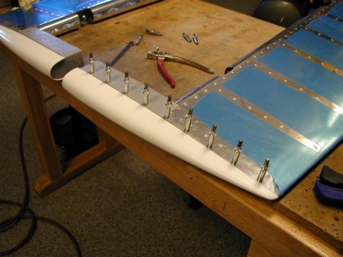

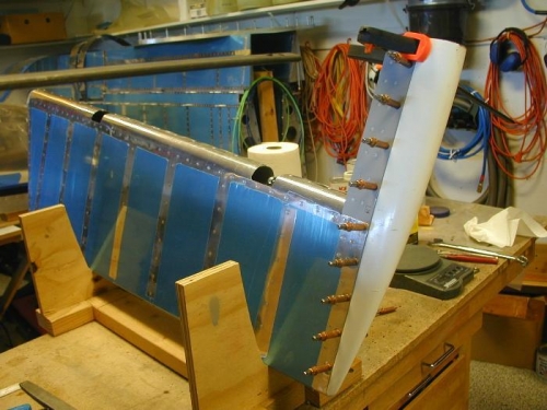

Elevator Plastic Tips 6
I enlarged all the holes to 1/8. Some spots on the aluminum came loose so I re-glued them.

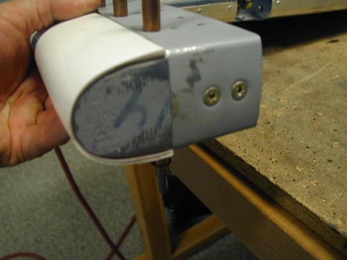

I cut the tips to length to be flush with the lead weight.
Plans say you gotta put glue on the lead weight to attach the fiberglass tips. I will use Proseal for this one.
Attach nicely
Drilled to 1/8
Cut to length
