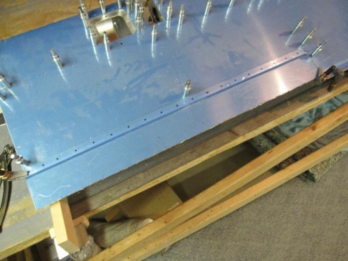

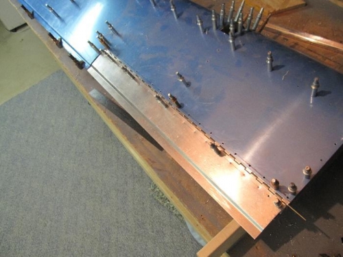

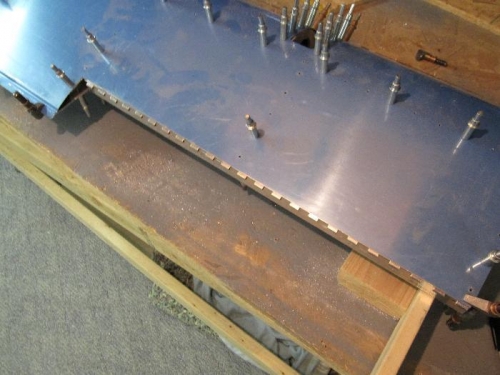

Brief Description:  Servo Tab #1
I fit the servo hinge and drilled the upper side forward and aft servo tab spars. I did come up with a good way to lay out the rivet pattern. I saved the skin cutout and used the pre punched holes in the training edge. I first drew a rivet line and lined up the holes. I had to flip it over to get good spacing on the inboard and outboard ends of the pattern. This worked well for both forward and aft spars.
Setting the rivet pattern
