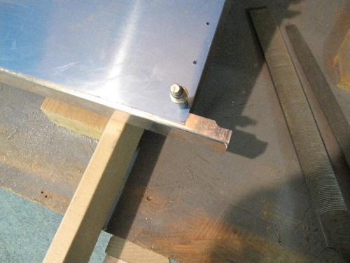

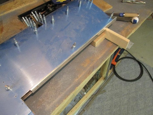

Brief Description:  Servo Tab Cut Out
I cleaned up the skin of the left aileron servo tab cutout. I also had to notch the forward servo tab spar because I could not trim the ribs back further with out violating edge distance. WIth an edge notch and one about the center of the spar it fit much better.
