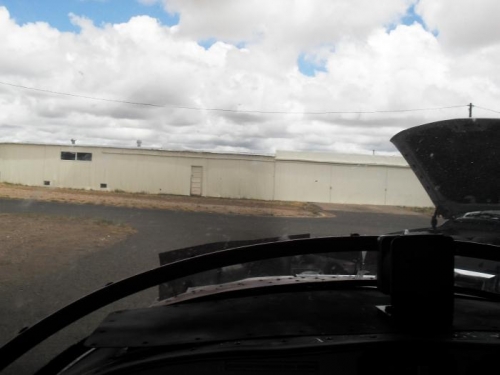

With everything working, I did the first formal engine run in the test procedure. The maximum RPM I could get was 2,000; the minimum was 850. These seem low and high, respectively. I can adjust the minimum number with the throttle stop;
I need to see if full throttle is really selecting full throttle. The aircraft is standing still, so the number I am getting are static, and in flight numbers will be higher.

First formal engine run - blur is the prop
