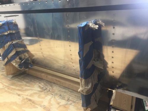

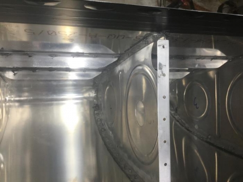

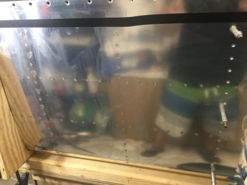

Brief Description:  Right Fuel Tank - Begin Sealing
Prepped the right fuel tank skin and ribs for sealing.
Sealed Ribs 2,3,4 in last session and 100% clecoed them.
This session, I cleaned up the holes and dabbed proseal in each hole then riveted all the holes in these three ribs. Cleaned up the outside of each rivet head. Came out good. I started sealing the manufactured heads of the rivets. Ran out of sealant before I finished.
