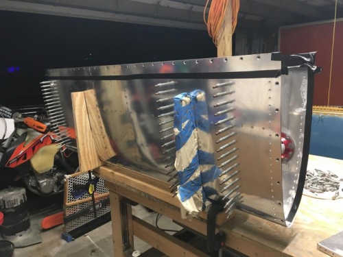

Brief Description:  Sealed Ribs 1,5,6 & Corrected Mistake

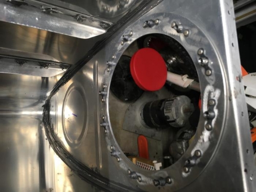

Realized I didn't add the nutplates to the backing ring on Rib 1. Drilled out all the rivets and added the nutplates and re-riveted. Need to order more nutplates.
Pro-Sealed Ribs 1, 5, and 6 and 100% clecoed. Did the same to the reinforcement plate on Rib 7.
Ribs 1, 5, 6 Sealed and Clecoed

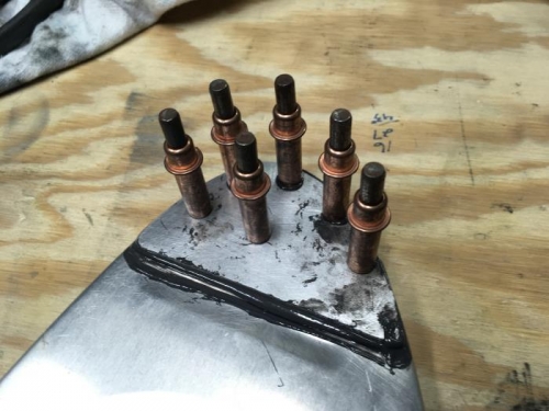

Rib 7 Reinforcement Plate
Rib 1 - Right Fuel Tank - WITH nutplates
