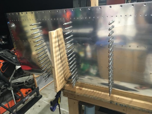

Pro-Sealed Ribs 2-4 into place on the Right Fuel Tank. 100% Clecoed.
Fully sealed and riveted the Fuel Cap Filler (with Vent Clip) and Fuel Drain Flange onto the Right Fuel Tank.
The rivets were a little short on both of them, but good enough.
Ribs 2-4 Sealed and Clecoed
