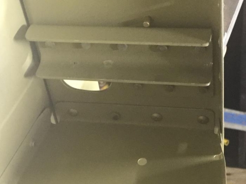

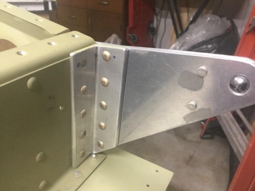

Riveted Outboard Aileron Bracket to Spar.
Riveted Flap Brace and Aileron Gap Fairing to Spar and Top Skin. UNFORTUNATELY, the last rivet can't go in because how close it is to the SB for the AGF internal angles. Also, those angles will prevent two rivets from being installed on the Bottom Skin. I emailed Vans asking for ideas. Maybe pull rivets?

My 470 rivets got better. Almost no smiley's next to them (bucked nor squeezed)! Removed all the tape from them so I could see the head better. But kept the cup sticky with the masking tape.
