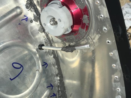

Drilled hole for Vent Line in Rib 1 (7/16").

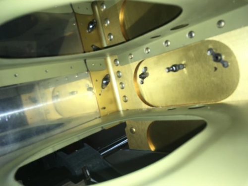

Riveted the three nutplates for the inboard fuel tank rib. Used a backrivet set and the tungsten bar. Much better than the Left Wing.
Installed the vent line, cut, deburred, and flared it. Came out nice and clean. Had to do it twice since I left the nut and sleeve off the first time.

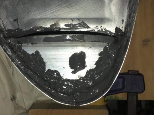

Riveted the two plates on Rib 1 on the R. Fuel Tank and gooped it all up with sealant.

Rib 1 Right Fuel Tank
Rib 1 Nutplates for R. Fuel Tank
Vent for R. Fuel Tank
