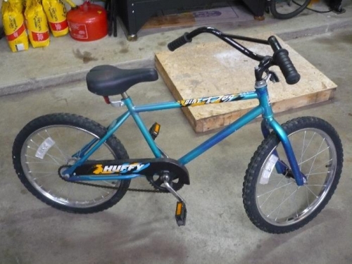

Made good progress today. Stopped by the Sunshine Thrift Shop this morning and picked up a donor bike for wheel, sprocket and 1" dia tubing. $12 bucks.

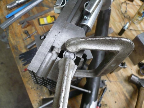

Drilled and tapped 8mm threads in the end of the steering shaft. Cut to length and made end to weld on the end of the shaft from the same 5/8" od tubing that is the bushing. This will act as a stop when the bolt is tightened. After welding the ring on the end of the shaft I cut a slot for a standard flat blade screw driver bit.

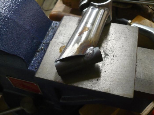

Welded bushing to the handel bar stem.
Donor kids bike
Donor kids bike
End of steering shaft
Handel bar stem
Handel bar stem
