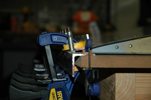

Brief Description:  Gluing the trailing edge of the left elevator
Today I cleco'd the left elevator to the angle iron, inserted the foams stiffiners, glued the trailing edge with proseal, and then clamped some angle aluminum to the trailing edge to provide a straight squeeze. This method has been great on the rudder and right elevator. Thanks go to Aaron Sims for the tip.
