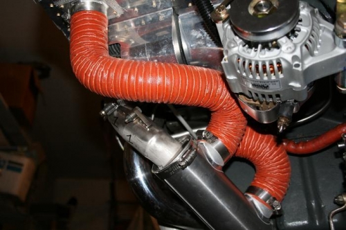

Brief Description:  Baffling #35/Cabin Heat Scat/Engine Mounts
-Finished securing the baffling that wraps around the cylinders and heads
-Installed the scat hose that runs from the inlet on the baffling to the muff and from the muff to the mixer valve on the firewall.
-Double checked the torque on the engine mount hardware and cotter pinned the hardware on the engine.
-Double checked the engine mount to firewall hardware - ran out of time before I could cotter pin them.

Scat hose running into and out of the exhaust muff
Routing around to the mixer valve
