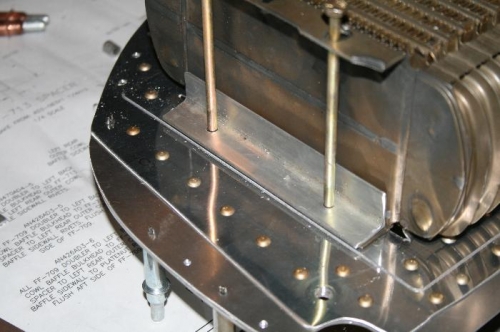

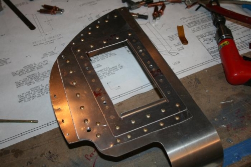

After readingt the horror stories regarding the baffling mounted oil coolers I decided to double up on the doublers, add reinforcement angles everywhere. The idea being the oil cooler and baffling will be able to withstand a thermonuclear onslaught....
Riveted the doublers on (all 3)
Fab'd reinforcement angles for the oil cooler mounting tabs.
I'm probably moving the stress to another place that will develope a crack...

Extra doublers riveted on along with the nutplates
Alum angle to reinforce the mounting tabs and spread the load

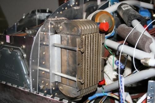

In place. I will relieve the upper rt corner of the cooler for the eng mount plus add another angle.
