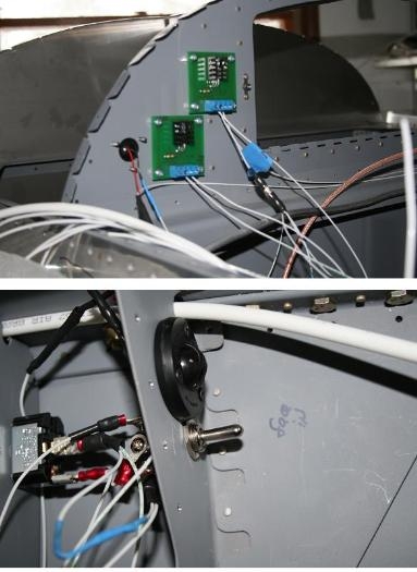

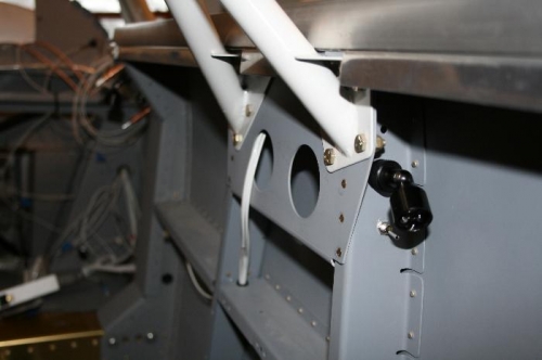

-Wired up rear maplight and on/off switch
-Wired up flood light on/off switch and fwd map light red/off/white switch
-Mounted the dimmer for the fwd map light (red)
-Partially wired up the dimmers (still need to mount the pots)

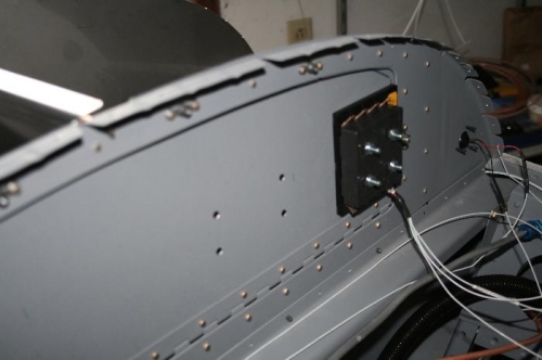

-Mounted the hot batt bus (HBB)
-Wired the flood, panel and map lights to the HBB

Rear map light and on/off switch
Top pic - Dimmers. Bottom pic - left console lgt and fwd map red/off/white switch
HBB
HBB
