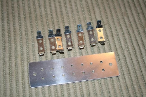

-Built a panel ground terminal out of tabs that came in my SteinAir wiring kit and some scrap material I had.

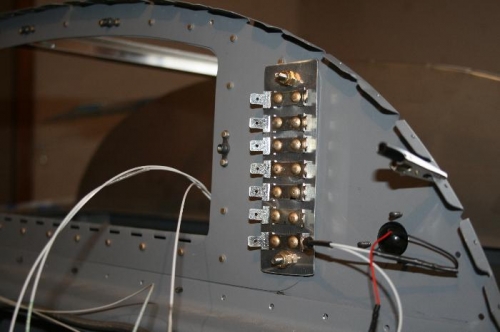

-Wired up the grounds for all the lights that weren't locally grounded (aft map and aft bagg).
-Wired up the hot wire for the aft map and aft bagg lgts
-Started wiring the aft bagg light

Panel ground
Panel ground
Panel ground mounted and the lights connected to one of the terminals
