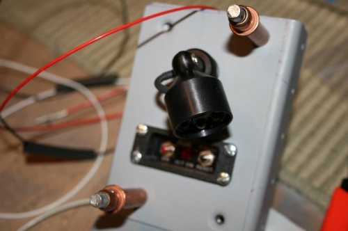

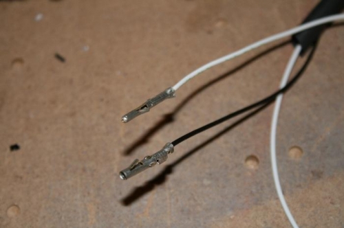

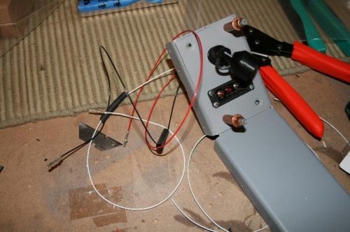

Brief Description:  Wiring Interior Lights #2
Solder the connections onto the map light wires. Used a modified version of the technique by Stein to use molex pins to act as semi permenant connectors. This way I can replace the light someday if needed. Otherwise they are connected and heat shrink is added to the junction.
