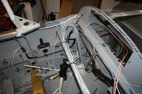

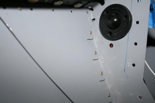

Brief Description:  Wiring Interior Lights #1
Got more parts in so I can continue my interior light circuit. I ran most of the power wires to the locations where lights will be mounted, but not it is time put in the dimmers, lights and switches and I plan to test the system since I made it slightly complex with my flood lighting arrangement. The flood light switch is strategically located where you open and close the canopy on the inside of the left cockpit sill and it pwrs every interior light on the airplane with a flip of the switch via hot battery bus power (no master switch on). I had to put in some diodes and wire the lights in such a way that they function normally when the flood light switch is off.
Today I soldered the right hand console (red) light to the power and ground.
red console light
red console light
plenty of wires already
