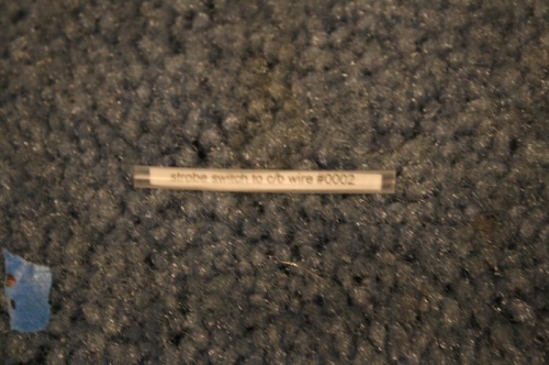

Although I'm not done with the wiring by any stretch in order to keep a handle on the mass of spaghetti this is errupting from my fuselage I thought I should put proper labels on my wires vs the masking tape loosely attached to each end (and anything else it encounters!).
Pretty mundane, but like my buddies say, nothing flys until it's all done!
I used small (#6) font on MS word and printed them out and then cut them out with sissors. I slide the labels into the 3/32 clear heat shrink tubing and heated it up. Works good for me.
Hard to read in the picture, but it says strobe switch to c/b wire #0002
