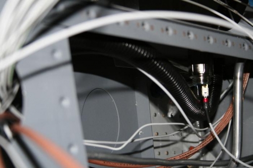

-Wired up the 12v socket up front in the right gear tower

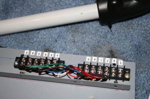

-Did the continuity checks on the infinity stick grip wires to make sure which was which and labeled them. I marked the letters on the spec sheet for the grip so I know what wires are which.

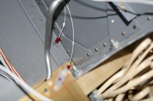

-I trimmed off the elevator trim (up/down) wires to length and crimped on the ends.

Stick grip wire terminals verified and labeled
12 volt socket power lead hooked up (#14awg)
Elev trim wires ready to go.
