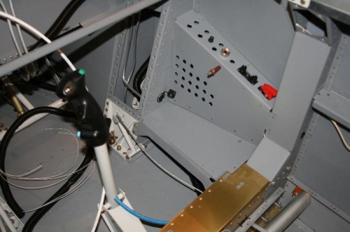

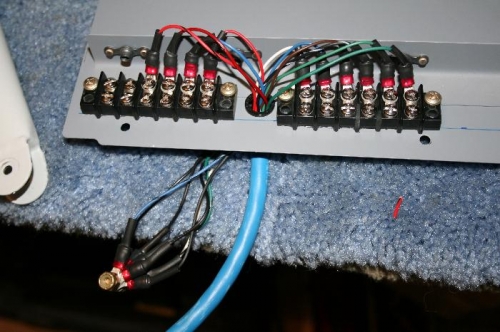

Finished wiring up the stick to the terminal strips. I tied the ground wires together on a #8 screw that serves double duty to hold one of the terminals in place. I attached an adel clamp to the wire just before the terminal to anchor it in place so the wires can't be pulled out of their connectors.
Here tis.
Here tis.

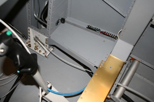

Here it is in place. The c/b panel covers up the terminals.
Here it is with the c/b and switch panel in place.
