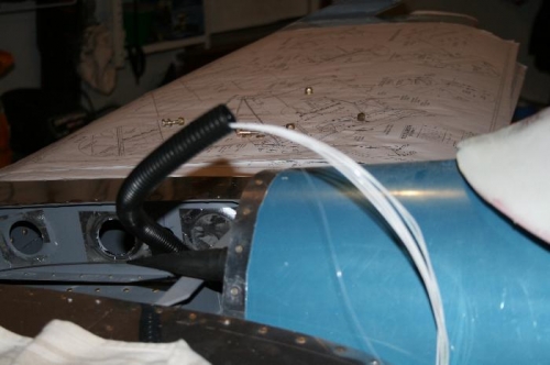

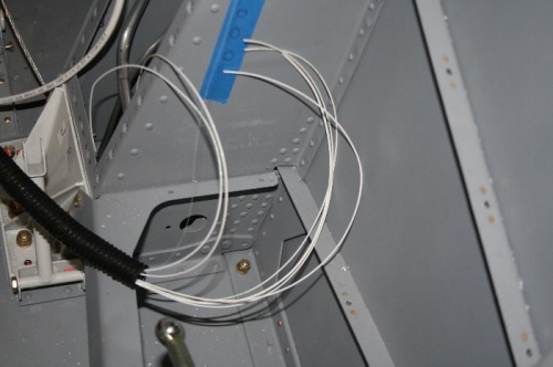

Pulled the 6 wires through the tail cone conduit. I had a false start on the first attempt this morning - cut the 5 22awg wires going to the elev trim servo too short - rats. 2nd attempt went splendid. I also pulled another fishing line through with the wires incase I need to add another wire for something down the road. The wires I have are for the tail position light (18awg) and 5 wires for the MAC trim servor (22awg).

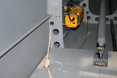

Opened up a hole on one of the tailcone bulkheads to put in a snap bushing for routing of the coax from the ELT antenna to the ELT unit.
Here's the wire I pulled through the fuselage and out of the end of this conduit.
Here's the other end that will end up in various points behind the panel
ELT coax attached
ELT coax attached
