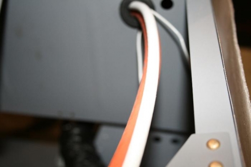

Brief Description:  Re-routed fat wires through baggage bulkhead+
With the installation of my fat wire firewall penetration, I need to change the fat wire routing slightly so I disconnected them from the starter contactor and pull them back through the firewall. I then located and drilled a hole in the aft wall of the baggage compartment just in front of the left gear tower. I installed a grommet and rerouted and connected the wires.

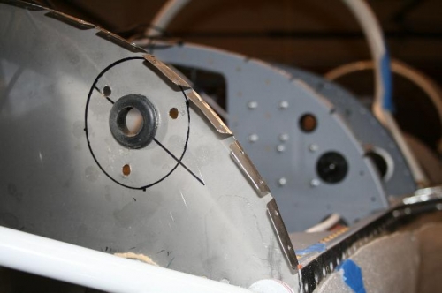

I then cut the other end off the ss handle and layed out the other firewall penetration (used for EMS and other sensors). I located it above the other one. I also drilled the hole in the aft wall of the bagg compartment for the same. In the end there will be two conduits running along the far end of the baggage compartment - as viewed from the baggage compartment door. This will create minimal loss of baggage space.
Fat wires moved up along the top longeron.
EMS wire holes (foreground / background)  drilled and grommets installed.
