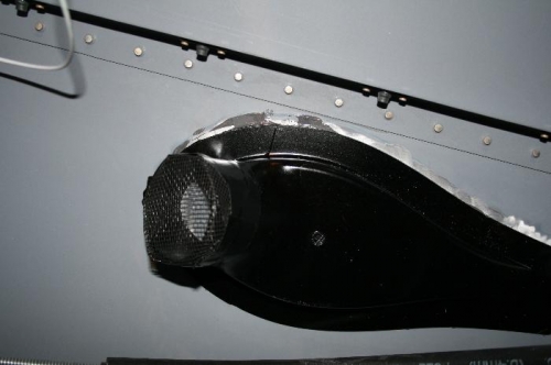

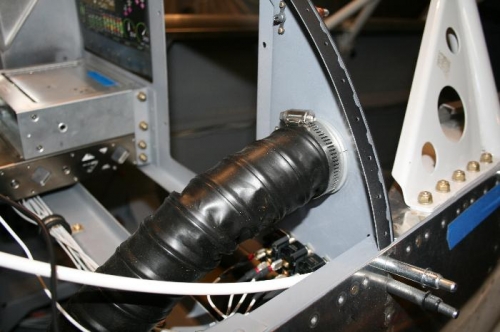

Holiday so not much progress. I hooked up the fwd air duct to the naca and the fwd wemac. I installed some screen at the naca hook up so I don't ingest a bumble bee.
-Somehow I didn't crimp the left nav light wire at the junction under the floor boards so I redid that connection.
-I then contemplated where to have the other firewall exit for the EMS and other wires such as GPS antennas, etc. I think I'll run them under the lower bagg door frame with conduit. Also I'm not happy with how I routed the power leads on the right side of the airplane as they go the firewall exit so I'll unhook them and reroute as to not interfer with the bagg shelf.
Bug screen over the naca scoop outlet
air duct hooked up to the fancy stein air wemac
