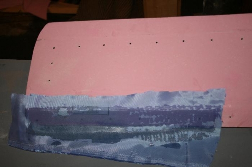

-Uncleco'd the skirt from the canopy
-Sanded the inside of the skirt at the aft junction and on the left side where I had layed up the glass on the outside
-Layed up 3 more plies for the aft junction and 2 more for the left side area
Looks good, now it can cure while I'm at work and we'll see about it when I get home.
Lay up on the aft junction (inside)

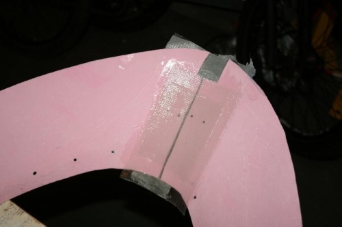

Here's the left side (inside) with peel ply on top.

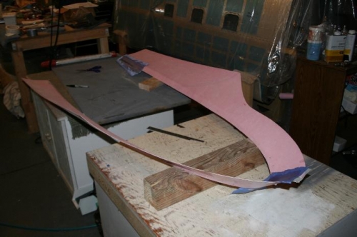

Here's the whole assembly
