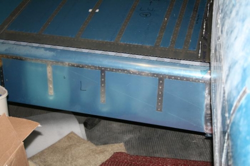

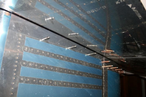

Brief Description:  wing root fairings #3 plus left flap rod install
-Marked a line 3/16 from the edge of the fuselage for both left and right wing fairings. Trimming to this line will allow room for the rubber seal that goes between the fairings and the fuselage.
-Installed the actuator rod for the left flap.
Picture is sideways, but you can see the black line denoting 3/16
Picture is sideways, but you can see the black line denoting 3/16" around the fairings.
Left flap rod being installed.
