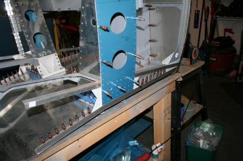

-Drilled the WD-822L/R to clean the powder coating out of the 1/8" holes
-Put the aux longerons into place. Had to re-bend both the left and the right one as somehow I read the plans backwards - I still don't see how based on how it's depicted.
-Cleco'd the gear tower spacer and the outer gear tower plates and confirmed fitment.
-Installed the center section out plate and confirmed fitment
-Installed the gussets and confirmed fitment.
I'm running out of clecos so I ordered some from 'The Yard' this weekend - hope they get here soon.
-Drilled the #30 and #40 holes that match the mid cabin braces and the center section.
-Uncleco'd everthing and deburred.
Right side longerons in place.

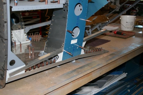

Here's the left side.
