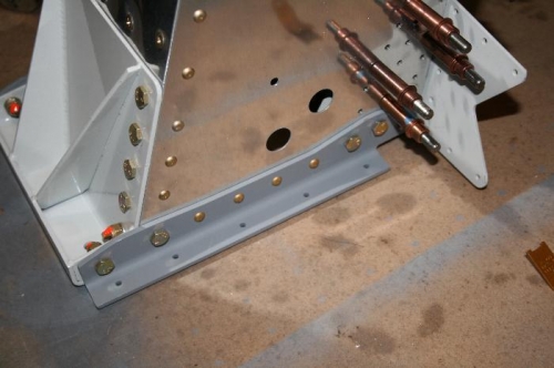

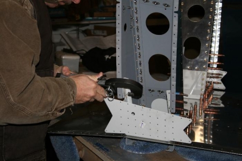

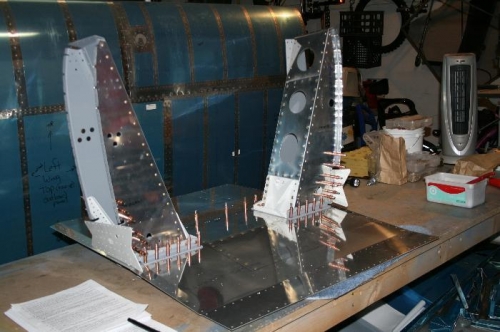

Good session this morning even if most of it was making up for the mistake noted in the previous entries. I riveted the corner angles back on and replaced the bolts and torqued them to 40 in/lbs and put thread-locker on each one (mostly so I know they got torqued). I then cleco'd the towers to the forward floor plan per the plans. Next step was start riveting the F-822 box weldments to the tower forward and aft bulkheads - see photos. I squeezed all of the ones I could reach with the pnuematic squeezer, the rest I will have to shoot with the rivet gun and bucking bar.
Corner angles back on (dark gray part) and bolts torqued (not orange lock compound)
Gear towers cleco'd to the forward floor panel - looks like something!
Squeezing the rivets that attach the weldment (light gray) to the gear tower.
