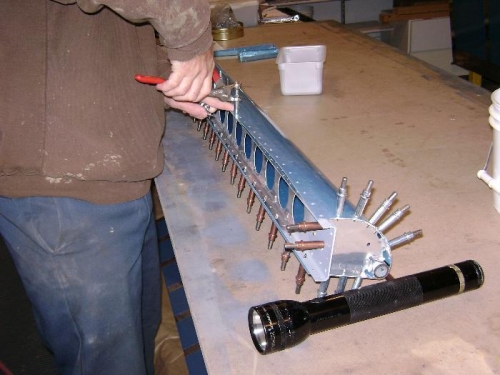

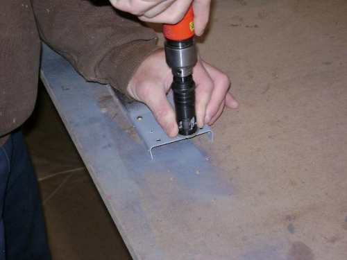

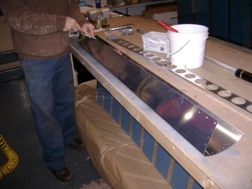

As I continue to work on the right aileron. I finished unclecoing the assembly and deburred all of the holes and edges this morning. Mundane but necessary work. Next step is to scuff the rivet lines and then countersink or dimple as applicable. Then it's prime and then rivet together. I should have the right aileron done this weekend.
Uncleco'ing the aileron leading edge
Countersinking the aileron end rib rivet holes.
Deburring...........
