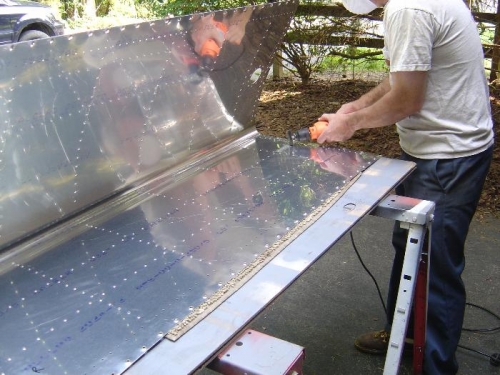

Brief Description:  Scuffing the right fuel tank mating surfaces
Prepping the right fuel tank skin for ProSeal. I used a wire brush and really roughed up the mating surface for all the parts that will eventually find their way to the skin.
45 degrees one way and 45 the other for each stripe
More of the same.
More of the same.
Done.
Done.
