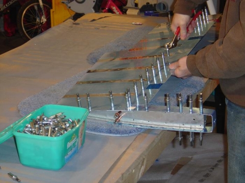

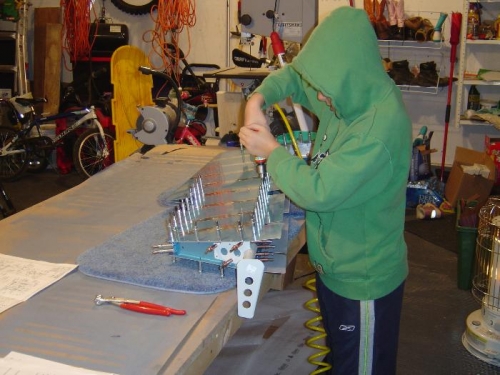

Up at 530am. Broke the left elevator with the homemade sheetmetal brake. Worked out great! Cleco'd the skin to the understructure and match-drilled. Match-drilled the elevator horn and trim tab false spar per the plans. Uncleco'd and started deburring. Hopefully tomorrow I can finish deburring and dimpling in preparation for primer.
Cleco'ing the left elevator skin to the substructure
Mitchel is match-drilling the skins to the understructure per the plans.
