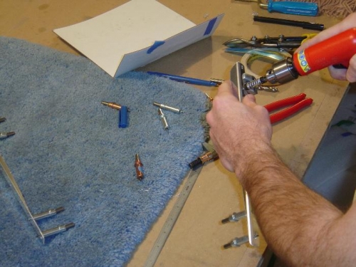

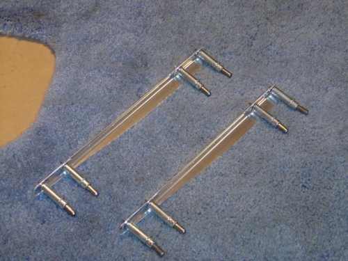

Well after cleco'ing two elevators stiffners in backwards and drilling, I am left with extra holes. I have 3 choices 1) ignore the extra hole and the implications of possible cracks due to edge spacing and eventually a possible loose (smoking) rivet. NO 2) order a new part from Vans and wait 2 weeks - MAYBE. 3) Repair the stiffners by installing a doubler - YES. I fabricated a doubler for each end of the two stiffners and match drilled them to the end hole (the problematic one) and the next good hole. See attached photos. I believe the repair will be at least as strong or stronger than before and only adds fractions of an ounce to the structure. After I was done I started scuffing the stiffners with scotchbrite in preparation for priming. I like to do that before dimpling so it is easier to scuff. I emailed Vans Aircraft to verify that my repair was acceptable and according to Gus at the factory, this fix is more than adequate.

Match-drilling the new doubler to the stiffner
Doublers cleco'd to the stiffners
