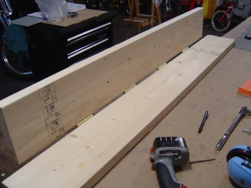

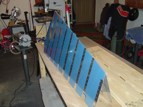

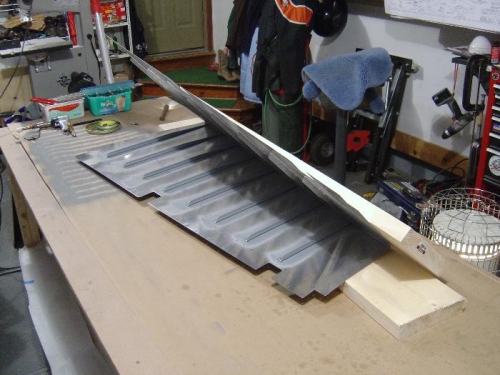

Built the home-made shetal metal break per the plans to form the trailing edge of the rudder. (:30) used 2x8s and cut them 60" and 54" long respectively and used door hinges. They leave the trailing edges unfinished so you can rivet the stiffners in place. I drilled out a "proud" rivet on the skin that I wasn't happy with and the new one was much almost perfect so I'm happy with that. Mitchel came out around 6:15am and helped me form the rudder trailing edge in the break. Took alot of force, but I was careful not to let the stiffners touch the skin on the opposite side and deform the metal. I literally stood on the break as Mitchel watched to be sure I wasn't over-squeezing it. All went well.
wooden sheetmetal break for forming the trailing edge of the control surfaces
The rudder getting ready to be squeezed to form the trailing edge
After forming the trailing edge
