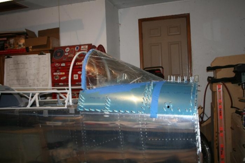

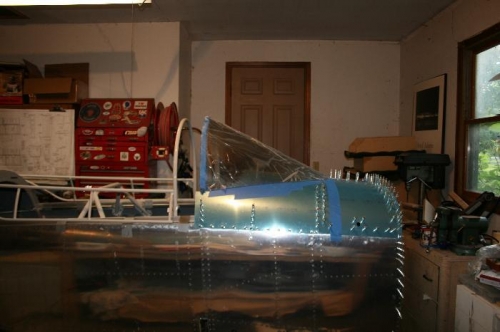

I'm calling the windshield done for now. I may do alittle more trimming when I class it in, but I believe if I keep tweaking it I might get myself in a corner. I did a little work getting the front more flush with the forward skin and then I put the cutting wheel back on and trimmed off the excess past the roll bar being mindful of the plans that call for 25/32 from point of contact with the weldment to the edge. This junction gets fiberglass so I don't believe the dimensions are super critical at this point. Glad to be done with that for now.
Side on view

Slightly off-angle view

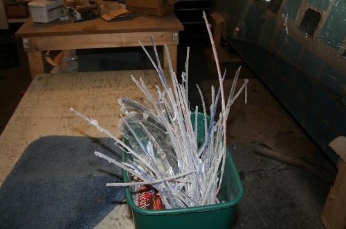

77+cuts
77+cuts
